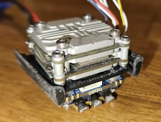

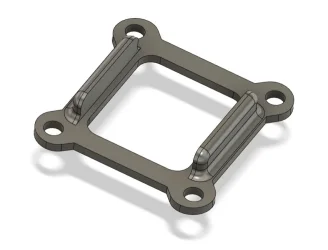

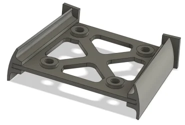

Updated some parts of my original MiniQ FPV build. Have added some extra cooling to motor mount extension. Also a tray that slots in the nose to hold FV/VTX and ESC. May be of use to someone else.
