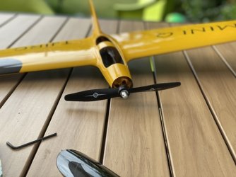

An inlet hole like this might help.
Thanks Konrad - here’s the mount - I’ve moved away from a folding prop as it didn’t have the power and also the esc wasn’t powerful enough to break so it was spinning and slowing me down further (see previous posts). So this setup is fast, cg is right and thinking about it I was on power all the way through as I was trimming/testing the battery weight (tried a few). So maybe if I take it easy and power on / off it’ll improve anyway. There’s no nose cone so plenty of room Ron air intake - I think I’ll try some holes in the canopy without making a mess of the look as it is a good looking model before I start hacking away at it!
I remember reading that exit holes had to be large in comparison with intake... but I don’t want to take too much out.... that’s why I was looking to see what others had done first.

A circle will flow better than a slit.
And yes as heated air will expand, if you want the lowest drag set up, the exit should be larger than the inlet.

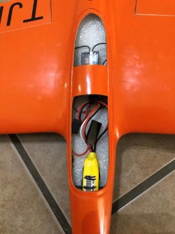

Mine weighs in at 360 grams with CG 20mm, measured like the drawing you provided a while back (refer image). I find it fly's best with 2.5mm of reflex, though I do have my reflex setup on my LD dial. This enables me to do fine reflex adjustments in flight depending on conditions. I've found around 3mm of reflex slows it up in light conditions but it also puts the Q on the edge of stalling and therefore higher chances of causing buffeting, especially when exiting turns.
I've X08H-Plus servos and LIFE-700 6.6V to power them, battery is held in place with stiff foam so I'm able to make fine adjustments with CG if required (refer image). Control surfaces (high rates) Ail +10mm -10mm, Ele +4mm -4mm. (low rates Ail +8-8, Ele +3-3) I also have approx 30% reverse differential programmed in when using high rates so my Q's barrel rolls are a very clean axial.
