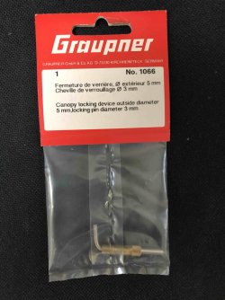

Ok - I hate to ask this, but what do you suggest as a solution?
And to be clear, your complaint here is the canopy stay? (and you would like to see the hinges flipped and the airfoil changed.)
In general I am not a huge fan of this style of canopy stay. They scratch up the paint every time you pull them off or on. Magnets always fail, fancy push lock things are expensive and kind of a pain. I guess this is why I tend to have tape on many of my gliders.

Ok, lets level set expectation. I am not cost driven but rather quality driven. I hold to the notion that one can't make a silk purse out of a sow's ear.
For example take a look at my efforts with the RCRM junk that is the Strega build I've post here on this forum. No mater how much I work to improve the product it really is a fools errand as at the heart of every component the Strega is poorly thought out and manufactured.
Now If I was to design this I would have had a carry through spar (structure) from the very beginning. Time and time again you and I have seen where the wings will crush the fuselage.
P.S.
No, My concern is that the carry through structure (new web) is not properly executed. I had given a detailed account in how to do this without needing to recut the molds as I assume the mold design is frozen (too expensive to retool).
