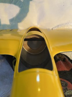

My 34mm spinner seems to fit well and this type will allow for some cooling air. My replacement servos should be here today, so I can install them soon. Once installed, I will put everything in place to see if my CG is even close to where it should be. Should come in around 485grams with a 3 cell 1350mahr; 9x6 prop.
