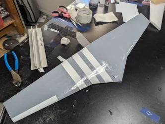

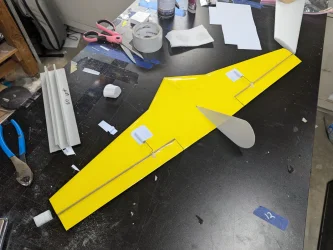

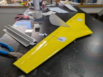

Mini buzz got flown probably a dozen times this past weekend. Great little wing. Still need to measure CG. Flew it in 12mph up to 27mph. It loves both.
Mini buzz got flown probably a dozen times this past weekend. Great little wing. Still need to measure CG. Flew it in 12mph up to 27mph. It loves both. View attachment 26067
