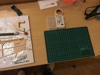

I'm currently stuck in a hotel so i brought the kit and a bottle of glue with me. I went to a local store and they had a small pieces of MDF I grabbed one to be my building board, i also picked up a small cutting matt a box of pins and a small roll of tape.

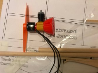

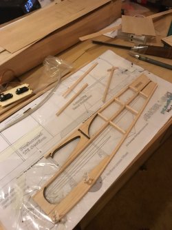

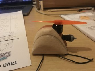

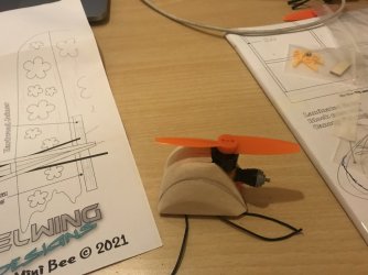

I started the fuselage today. I got the first side framed up. Pretty traditional building the laser cutting is pretty good not to much burn marks on the back side. The motor im going to use is an emax 1106 bolted on to a 3d printed motor mount that looks like an old TeeDee 0.010. This will require quite a bit of rework to the nose and canopy area. But hey i've got time.

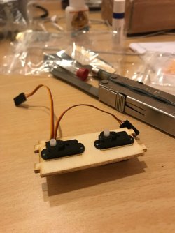

Hey Thanks for all the comments guys. Not much done yesterday i had to work late. I did fit the servos to the servo tray. Much easier to do this now before putting the tray in the fuselage. The servos are Power HD HD-1440A that i got from Aloft hobbies.
Hank

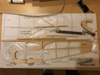

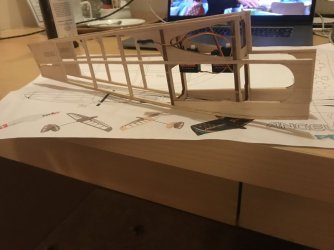

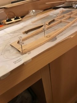

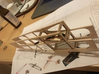

Ok a few small updates, I got the second fuselage side built. Here is a pic of it still on the board. I have pulled it off the board but both sides need to go out side to be sanded. The film i used to protect the plans stuck pretty good to the balsa with ca. I looked at the sides and they look good The formers fit ok. Now that i have this off the plans i can start to draft a better nose for the motor system.

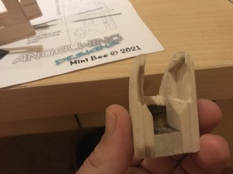

Well I’ve done a bit more work on the mini bee. I glued up the cowl. It is laminated from several pieces. I laid the out and cut what I would need to cut for the motor, before gluing all the parts together. It’s coming along well at the moment. Still needs lots of sanding and shaping.

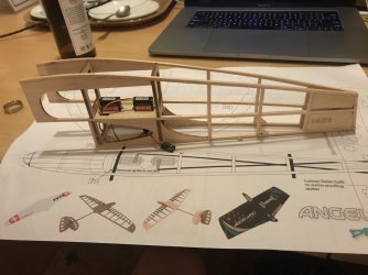

Ok here are the pics I promised. I pulled the fuselage sides together and one set of stringers was denser than the other so even though the rudder post is in line there is a bow to the fuse. I’m going to live with it. Won’t be able to tell when the wing is on and it won’t affect the flying.

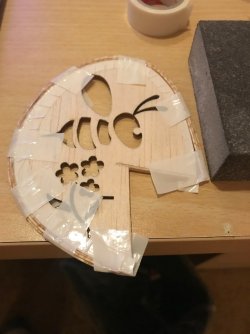

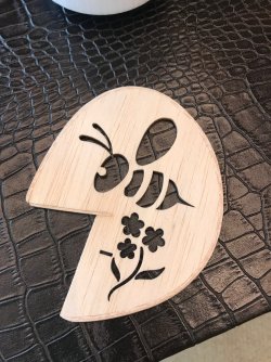

Ok, another small update. I've done a bit more work on the fuselage but i'm not really happy with it so i've set it aside to work on some other stuff.

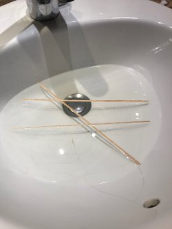

The rudder is a single sheet item and has a bunch of holes cut in it that look like a bee and a flower. This looks cute but makes the rudder really weak. I've decided to keep the rudder with the bee since my daughter said she liked it. So i added a strip of 1/32 balsa to the bottom of the counter balance area to add some rigidity. That didn't really add as much as i would like so i sanded the o.d. back about 1/16 then added 2 laminations of 1/32 to the out side. I cut the strips for the laminations from scrap wood in the kit, let them soak in the sink for a couple of hours. I put tape around the rudder so the water wouldn't affect the wood much and i used tape to pull it around. After waiting a few days i glued the lamination on and sanded everything. It is much stiffer and will definitely help when i cover it to keep it from warping.
Normally in this situation i would have just made a whole new rudder being built up with the wood grain running the correct direction every where. However this is an ok compromise. I will do the same with the elevator and horizontal stab since it suffers from the same issues.
