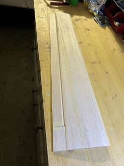

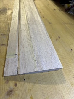

Curious what you guys think about making the ailerons bottom hinged rather than top hinged. (opposite of how it is in the bare wing photo, and opposite of my current plane). Seems like bottom hinged might be slightly more efficient since bottom airflow would be smoother. Any thoughts would be appreciated.
I know it’s 90% about the flying ability rather than the plane, but JJ flies really smooth and I need all the advantage I can get. : )
Still have some more sanding to do.
I’m making two new ODR’s one will be the brother to this Bad Voodoo Pro which is getting a bit beat up, and another will be a “Pink Mess” ODR from Canuck.

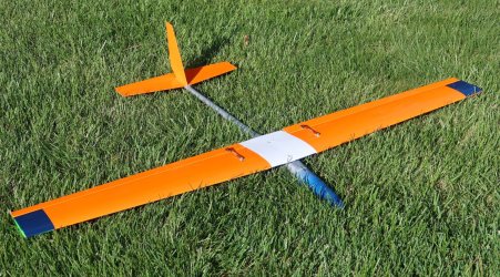

For a ODR slope racer you don't need a lot of aileron (flaperon) throw. Since I wanted to have the option to slow my Voodoo Child down for landing I have used a bottom hinge to enable significant flap actuation. A top mounted control horn has less chance of getting snagged on landing (unless you land inverted) and allows for easy linkage inspection prior to flight, or adjustments when trimming.
The only advantage I see for a top hinge system is that it looks cleaner when the plane is laying on the ground (horn and linkage below the wing).

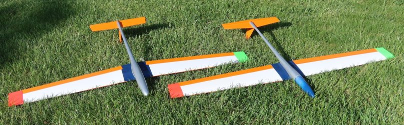

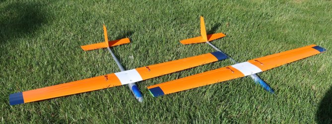

So the Canuck (Andrew) made a bunch of ODR kits in varying level of completeness to assure a good stock of airplanes at WOW, the Midwest Slope Challenge which is next week in Wilson Kansas. Here is my version of his kit which I call a Blue Mess. Also a pic of it's sister the Voodoo Child which is a derivative of the Bad Voodoo ODR kit. The Mess weighs in at 26 oz which is just above the low weight limit. I've built in a ballast mount and stick based on some F5J ballast setups. Will need that for racing.
Some detail. The main difference between ODR planes is the fuselage. My Cobra has a shaped and gooped EPP fuse which is durable but probably a little draggy as well as a little shorter than max allowable length. Both the Voodoo and Mess designs have very sleek glass fuselages that are the max length as per the ODR rules (36 inches). The thin, smooth cross section along with a longer tail moment should be beneficial. The ODR spec requires a 7" root chord, and a 5" tip chord with straight taper only. The Cobra has a staight TE. The Voodoo has a straight LE. My Blue Mess has 1" of LE and TE taper. Doubt the type of taper has any perceptible effect on performance, but it may influence stall or snap behavior in a tight turn. Hope someone is watching and oberving that because I plan to focus on flying and racing.
There is no doubt that bottom hinged wing control surfaces work better. Tested and proven.
The airflow over the underneath of the wing is always smoother than the upper surface, and its best to try to keep it that way.:cool::cool:
