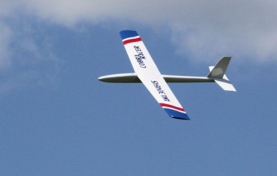

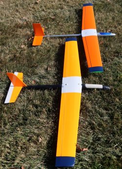

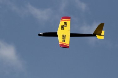

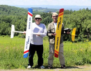

I like the Magnum Models COBRA RACER for ODR.
That plane does much better than most of my others for inland slope soaring when the wind is up.
I think Larry will make you a kit on request.
Ask him in email to know for sure.
Larry Blevins <magnumrcmodels@gmail.com>
