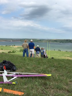

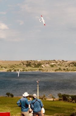

A couple of ODR pics. Fist pic would be pre race altitude gain before the buzzer. Each pilot has a caller behind him to tell him when to turn a the far end. Floggers are at far end. It is fun that your caller is helping you on one race but is competition on another one.

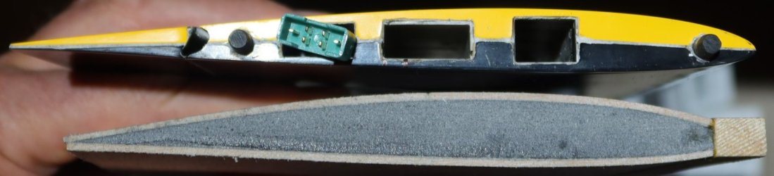

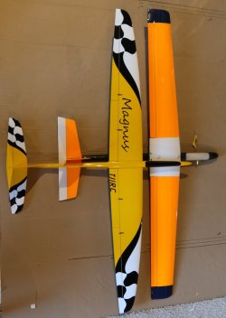

Some pics and comparisons to the similiar (wingspans and vertical stabs w no rudder the same), but in almost every other way different Magnus 60.
ODR 750gr, Magnus 1050gr (unballasted). ODR 9.5% airfoil thickness, Magnus 8.5% airfoil thickness. ODR foam and balsa wing/tail with glass or EPP fuse, Magnus Carbon fiber (except for the hatch). ODR straight line LE taper, Magnus curvy.

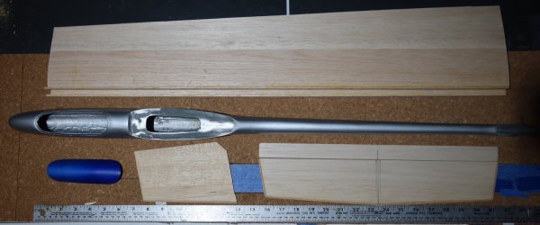

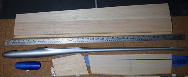

My Cobra ODR has been around for many years, but at the spring WOW some folks had obtained or built a few glass fuselages to help pilots refurbish their fleets (they vanished quickly). The pics are from my current build for the new sleek but sturdy glass fuse. The wing is just 1/16th balsa over foam cores cut to the spec SD6061 airfoil thickend to 9.5%.
