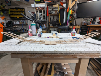

Jumping the gun a bit. I wanted to see if my new tip structure was strong enough and if the structure would allow Litespan to "flow" properly.

The covering is a "process" sold by Solarfilm in the UK. Unfortunately they have stopped production. The site is still active as the owner is selling off new old stock. If you have used any of the Solarfilm products you know how great they are. Far better than the last iteration of MoneyKote!!!!. But as the product line isn't manufactured anymore I can't recommend the products for a novice. If you know what it is ,then yes stock up on what is left.
As to covering techniques I learned most of them from Harry Higley Tom's Techniques. Now I do love the printed word, but this is one time a video might actually be better at showing how to stretch and shrink the film. Again I don't think micros are the appropriate model to use to learn these techniques. They are just too fragile and actually don't have enough area to "hide" the excess material. That is you really have to get the covering on with as little slack as possible. Then shrink for the final finish. This can be difficult at first.
Well @Red destroyed my dreams and says i shouldnt use regular iron on film so what are your suggestions for USA stuff for covering these micro's @Konrad ?
Last micro i did (pug twisty) i just had used what they had from angelwings, but not sure what light stuff is called here in the states.
Hum, I must have a credibility issue if it takes RED to drive home the issue with covering weight/ pull.
Ok, for this type of structure I'd be looking at 30g/m(2). This is in the 2 micron mylar with tissue range. This is a lot of work for a novice builder. Today the best off the roll covering I know of is Oracover lite. This is about 36g/m(2) or 20% heavier than what I'm using. I think it is marketed in the USA as Parklite.
While it is a bit heavier than So-Lite it (Parklite) is a lot more durable and easier to use than So-Lite. Oracover lite is a good covering for the novice to microRC.
As the Gentle Lady has few compound curves it is a good model to learn to cover. The micro Gentle Lady has much the same benefits but is a bit more critical about the forces used to manipulate the covering.
P.S.
Some folks are using HK "China Coat" [58 to 62 g/m(2)]. This covering is having a durrability issue as it is not colorfast. Now, I've never used it.
We rub each roll with helium to make it lighter.
The solid colors tick in at about 6 grams per sq foot. I'll let someone else convert that measurement mess up.
Use 39.37” per real unit of measurement, the meter. HK I think is closer to 5.67 g/Ft(2). That’s the same within experimental error and rounding errors to 6g/Ft(2).
0.12oz/Ft(2) = 36 g/m(2) Looks like my units line up.
I think this is the stuff (rebranded) that these micro where designed to use So-Lite 20g/m(2). Great stuff but it does tend to stick to itself when the clear covering is off. Also the adhesive is prone to delaminate from the plastic film over time.
