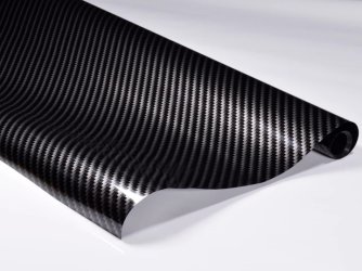

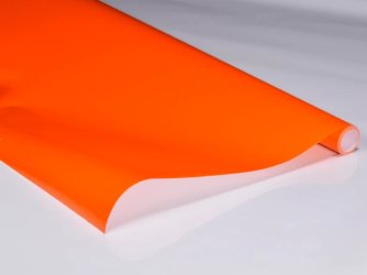

Oh Yeah!!! I've been waiting for this to stock. I can finally cover my Angel wings SOAS that I got from @Red at sunset 2022.
Looks like a great selection of colors also. just ordered the Carbon fiber, flouro orange, and Gray. Under $10.00 each and only $30 shipping to Hawaii. Awesome value for me here. I got the orange to match the erupting volcano Mauna Loa that's about 30 miles from my house. 🔥
