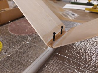

Update with picture here:
The demountable stabilizer worked out great, I think that's going to work fine. Still have to do the
control horns and clevises. I'm forming the nose out of foam and filler now, plan to glass it over
and remove the foam for a hollow nose that I can fill with lead.

That looks fantastic! I think the flipper extension will add some stiffness with the cross wood grain effect.
I assume you will be using nylon bolts on the slope.
Again very well done.
