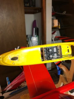

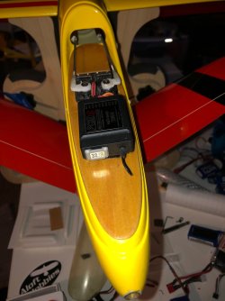

Ed, is that a tow release hole in the nose of your Hobie?
BTW, I'm finishing a Art Hobby Thermic JK, 2.5m. Added flaps and stuck some HS08 servos in it. Wood finish on these planes is supper nice!.
Apparently so....It came to me that way. I haven't bothered to install a release yet. The deck was a mess, so I used a piece of Basswood to cover it up.
