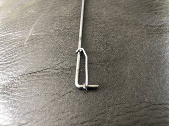

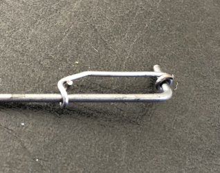

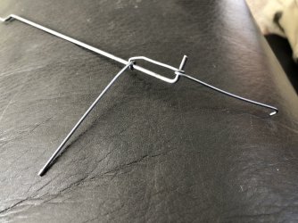

Anybody know of a cleaner way to retain the wire? The GWS retainer looks a bit bulky and might be a problem if I need to come up from the bottom (next to the skin).
This might work for you.
Pics before and after trimming.
Make two loops in the same plane.
Then twist one 90deg.
Keep the loops tight and circular.
A pair of fine round nose pliers are good for that.
You might experiment with wire size and distance between loops.
Add heat shrink if desired.

Looks interesting. No need for heat! Can one slide the retainer on and off relatively easily and still maintain decent retention?
