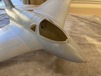

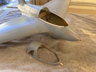

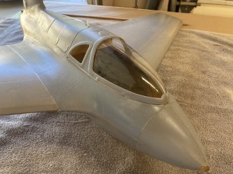

Well I’m short a couple hinge points for the rudder, but other than that it’s built and ready to start the painting process. I won’t bond the glazing in until after it’s all painted.

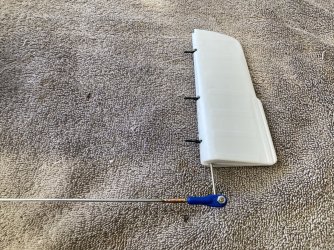

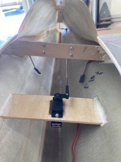

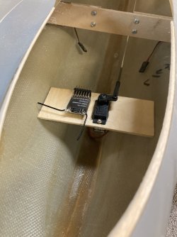

Got the rudder hinged and servo tray bonded in. That completes the mechanical part of the build other than setting the CG.

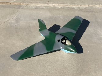

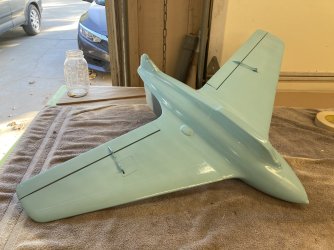

I sprayed some color on the bottom side. The actual color is supposed to be RLM Duck Egg Blue. I don’t have any decent shops around that carry plastic model paints, so I’m making due. This is not a scale competition build anyway, I think it is close enough. Once the shading and weathering is done that will help. I need to work on finding a couple suitable greens for the top side.

Got some color on the top side now. I’ll add some dark grey for camo, then flat clear over the whole thing before markings and weathering.

I like the rudder linkage Red, I’ve been thinking about getting a Magnus and putting a rudder on it using a closed loop system. I hate stuff out in the breeze though, so you’ve just given me some inspiration!

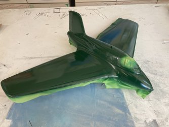

All the base colors are down now, but I’m not happy. The junk Rustoleum wrinkled all over the green and grey. So that sucks. I really don’t want to sand it off because I will lose all the panel line surface detail. So at this point I’m going to let it dry for a week or so, then it will get a flat clear. I will then paint the rest of the markings and it will get a healthy dose of weathering. It will be a 10 footer for sure!
Sorry to hear that. She looks really good in the photo.. Sounds like a good solution.

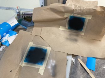

I’m drawing the bar crosses in CAD along with the other markings. Then I’ll cut them out of masking film on my cheapo eBay vinyl cutter and use my airbrush to paint them on.

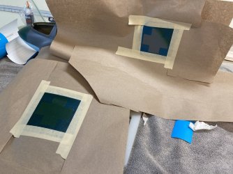

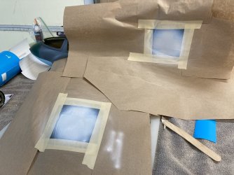

Looping back to this one, I began with adding the bar crosses. I cut masks from vinyl masking film with my sticker cutter. The turned out just OK. The masking is a little thicker than I would like, so no matter how well I pressed it down it wanted to lift where the previous wrinkles were. Even with heat. But I got them painted and again I plan to hide everything with lots of weathering.

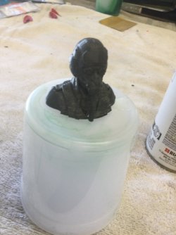

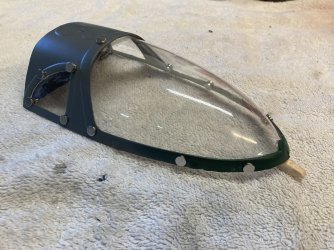

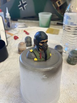

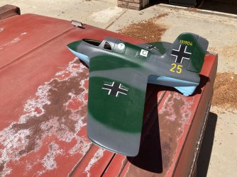

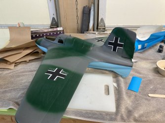

Getting back around to this one. I finished up all the markings (all paint) and sprayed that with flat clear. Tomorrow I will attempt to add some weathering and then we will call this one done. Magnet clamps and RC-56 glue for the glazing and my meager attempt to paint a 3D printed pilot. It's gonna fly this year!
