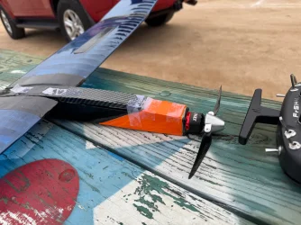

I had a lot of problems with motors on my ELI. The big 12 inch prop used with the Hacker kept hanging up on the square fuselage. Plus even when folded properly lots of drag. I just slapped an Emax motor on the front and its great. Tons of power and very smooth. If that motor out in the breeze decreased glide performance I don’t notice it. Will maintain altitude on only 20 percent throttle. Not had the guts yet to climb out much past half throttle. Might go strait up.

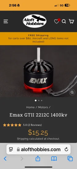

At the time of design the Emax motor was our smallest easy to source cheap motor with plenty of thrust for the mission, and many manufacturers of outrunners offer something in this size. I thought I'd be in the ballpark for CG with the battery under the hatch. (I have a long history of building or suggesting smaller motors that many people find too weak for the application, I didn't want to do that again.) Sadly, I was wildly off on the nose and tail moments for setting the CG. The tail moment is kind of short, and the tail is very light. We ended up with the servos near the wing bolt, and the 3S850 battery fully under the wing. Only the motor and tiny ESC were in the nose.
