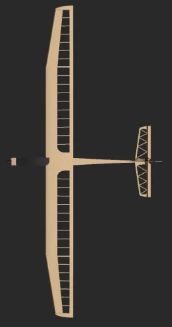

Thought it was about time to share what I have been working on. This plane is not yet named, for now we can call it the AH68 as it has a 68" wingspan. Simple 2 channel modern classic using AG airfoils blending through the panels. Why 68"? I wanted a mid sized model.

I wanted a plane a little bigger than the Mini Wanderer (45" wingspan). And I wanted a little more complexity to the build. I'm targeting folks that have built the Ridge Runt or Mini Wanderer and want a little more advanced build. She is still designed to go together easily, but the sheeted wings make things a bit more complex to build. The tail is also built from many small pieces, but we do all of the cutting for you. (The design of the vertical may change to match the horizontal.)

The wing is nearly all balsa, except for the center wing support and a bit of carbon. This is a 2 piece wing for easy transport, and a single 3mm nylon screw secures the wing. The screw is designed to shear off in a bad landing to protect with wing. A look under the wood sheeting:

I have enjoyed sharing the development with Konrad, and he has contributed many great ideas that no doubt has made the wing better and far lighter that my original.
I did debate keeping this a 1 piece wing, it would be lighter, but for me the 2 piece makes more sense. Even as a mid size, the polyhedral 1 piece would take up a lot of space when transporting and storing. Just much more practical in my mind. Someone could build this as a one piece if they wanted.

An interesting size. Thermal pilots might say “make it 2 meters and add spoilers”. One small point or suggestion, most of the 2m res gliders have such narrow fuselages that installing motor, battery and esc can be a nightmare. Adding a few millimeters in width can’t really hurt performance that much. Will be interested in progress and final weight.
Yes, my original design was a pure glider and it was MUCH thinner. I then backed up, spec'd out the motor and went from there. The fuselage width is set to the spinner we felt we needed to run, so we are right at 40mm. This gives lot of room to use different power systems. Also, not shown is the use of large triangle stocks in the corners. I expect builders to sand the heck out of those corners! Should end up with very pleasing curves.

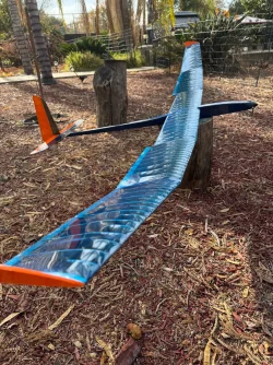

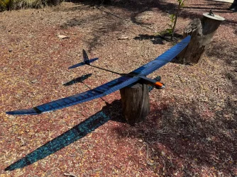

This is my just completed 2M Eli RES. AUW is 500 grams with a Hacker A10 4/1 reduction drive and 12 x 8.5 prop. Climbs like a rocket.
I think your design is great but a few observations from a recreational flyer. The majority of flights are just a quick climb to 400 feet and then a serene glide back to earth. Min sink is more important than L/D. The F5J 4m carbon wonders may really fly from thermal to thermal and adjust flaps for the perfect speed and airfoil. But for most we just blunder into lift and are thrilled to go up. So for me floaters are the way to go. Low wing loading and slow flying. I have learned that fast climbs are important. Keeps the motor cool and gives a better ratio of time to power on versus power off. Just some thoughts. Tom.

Very nice Tom. Looks like a nice model. Curious if you get any wing flutter if you let the speed climb too high? Looks like they are fully dependant on the film to control wing twist. There are a number of RES designs that use the same basic wing design, and I always wonder if they flutter.
Thank you. Thats Aloft transparent blue btw. A great price and almost as light as Oralight. So far no flutter but I tend to fly slow. My Hollien Introduction is the same wing construction (also covered with Aloft covering. No flutter so far.
