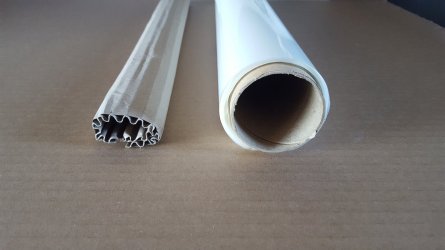

It would be nice if you rolled it on a tube. Mine was a bit mushed on the homemade cardboard thingy. I rolled it on a tube but im not really set up to do this and it took awhile to get it rolled nice and smooth. I did have 50 feet of the 1.7mil but its nicely rolled now

Another Customer's perspective of packaging.
That cardboard tube would probably costs as much as 4 or 5 meters of the covering.
I know that the shipping/display box of many products often cost more than the product. For example the box that Guillow kits comes in, is the single most expensive item for the manufacture.
From here the film looks to have arrived in satisfactory shape and suitable for its intended propose.
I think we are lucky that this film isn't folded. I often get a lot of light films that are folded. I'm thinking of some Coverite products and R.A. microlite. It was folded to save on shipping and storage costs.
That rolled up corrugated cardboard looks appropriate.
As an end user of this material I don't want to pay for items or services I don't use. I have no use for that cardboard tube or the added cost of shipping oversized packages.
Aloft please keep the cost down and at the same time protecting the product from creases. I think the loose corrugated sheet (roll) meets with most customer's expectations.

Sure Konrad, I should have taken a picture before I re-rolled it. It wasn't folded but it was not rolled very well on the crunched up tube. Thought it needed to be put on a roll to keep it from getting the creases as you put it. It would be simple to setup a spooler and to produce a better job quicker, so I don't think the costs would be much different but the result of the customer getting professionally wound material free from creases would meet or exceed all customers expectations.

We have never found a suitable tube that as Konrad points out does not cost a small fortune to roll the material on. So this is our solution. I will say that we all hate rolling this film out. We use a little "tool" that I made many years ago. We are always debating about a better way to do this, but nothing comes of it. I think we will make a second tool in the future so we do not need to reload the master rolls as often, the current tool only holds 4 master rolls, 7 would be better and a bit more spacing.
We have debated a much more complex tool that would allow us to roll the film without a cardboard roll at all, or maybe make up a roll from paper, but I think these would allow the film to smash down even flatter in shipping.
The 1.7 roll material you ordered is the toughest to roll out cleanly, especially in longer lengths. Heck, our supplier occasionally botches the job and sends us a worthless messed up roll.
We will keep putting thought to do this job better, but for now I'll ask the guys to be a bit more careful with the packaging in the box.
-Wayne
p.s. Thank you very much for the feedback.
p.p.s. When I was first starting up the business in my garage, I used to roll this stuff out on my floor after cleaning the floor carefully!! That was a real pain and always had some dog hair etc.. After doing that a couple of times I built the rolling tool.
