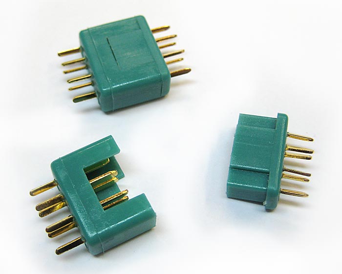

So something like this maybe?
Yes, that will work, but make sure it is a good connector. There are a lot of cheap versions of that connector out there these days that are not the most reliable. I like the MPX 6 pins, never had an issue with them:

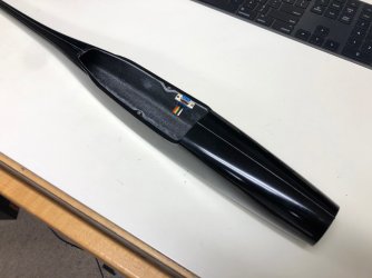

@Wayne cheers for the build pics! You mentioned grinding down the rear fuse to allow control horn clearance at down elevator. Am I correct in guessing you removed some material on the inside of the boom roughly in the circled green section?
I honestly do not recall. Chances are things may have changed since I made mine, TJI is always looking to improve the products.

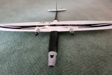

X-ray is getting the same treatment as the Mini Q. Since it can hold 21700s, the goal is 120+mph for 10+ minutes.
That goal should be very easy to achieve. I'd guess you could do that with a little over 300 watts.
Jarron had a small setup that consumed about 230 watts with 100 mph speeds. (single motor)
The dual motor will cost you a lot of extra watts, but since you are not trying to go super fast, should be very doable.
