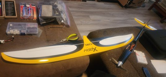

Well i stuffed my Jibe 2 a couple weekends ago on a full tilt pass, scraped the runway and unfortunately that wing is held on by tape and that scuff was enough to alow the wing to eject. 185mph+ lawn dart. Just ordered one of these to replace it, swapping over the power system. Should scoot well. NEU 1110 1y and CC 100A. Mostly run on 3s with 5x5 some 4s on 4.75 props but 4s really jumps the amps. Lookin forward to getting this in the mail.

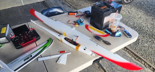

Just picked a used one from here , super excited , I dont want to fly my x-planes every weekend fearing of damaging ..looks like this is a good mini replacement .
this comes with with HET 2w-23 ,2900kv ,APC prop 5.5x6.5, planning on running on a 4s 2200 mah Hv SMC lipo.. what speeds can i expect from this set up?
also I saw a few program flapperons to slow the plane, can anyone please give me some info, any mixing with elevator etc ..Will soak up all the info i can over the weekend to fly this pretty plane .

Should reach about 180 MPH on 3s and break 220 on 4s. You're going to want to go to a 100A ESC on 4s though instead of the 70A that's in there though.

Keep us updated on how it goes. I took the power system out of my jibe 2 to put in my x-ray build. Similar setup. Neu 1110 1y, cc 100 lite, 5x5 on 3s 2200 went low 190s on the jibe which was a bit bigger and heavier. Touched 200 on 4s and 4.7x4.2. but would quickly heat up and over amp and pull power. Can't wait to give this little one a try as well.
