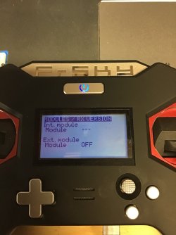

I got a Xlite S here a couple years ago as a spare TX, but I didn’t use it last season. Now I want to use this TX with a new RX6R receiver, but I can’t bind them together. I updated FW for both TX and Rx using the latest files from Frsky download page. When I tried to update FW for internal module, however, I got an error message “FW update error not responding”. When I checked the existing FW version of the internal module in the Tx settings, it showed only “- - -“.
I tried to bind the Rx with the Xlite in either ACCESS or ACCST mode, but it won’t bind. I also tried earlier FW version, but no success either.
To make sure there is no Rx issue, I tried my Horus and I was able to successfully bind that Rx to my Horus without a problem (both ACCESS or ACCST mode worked).
Does anyone has a suggestion what I’m missing, or what could be wrong with the Xlite?
OpenTx fw version installed: 2.3.14
Rx fw version installed: 2.1.7 (for ACCESS)
Thank you!
