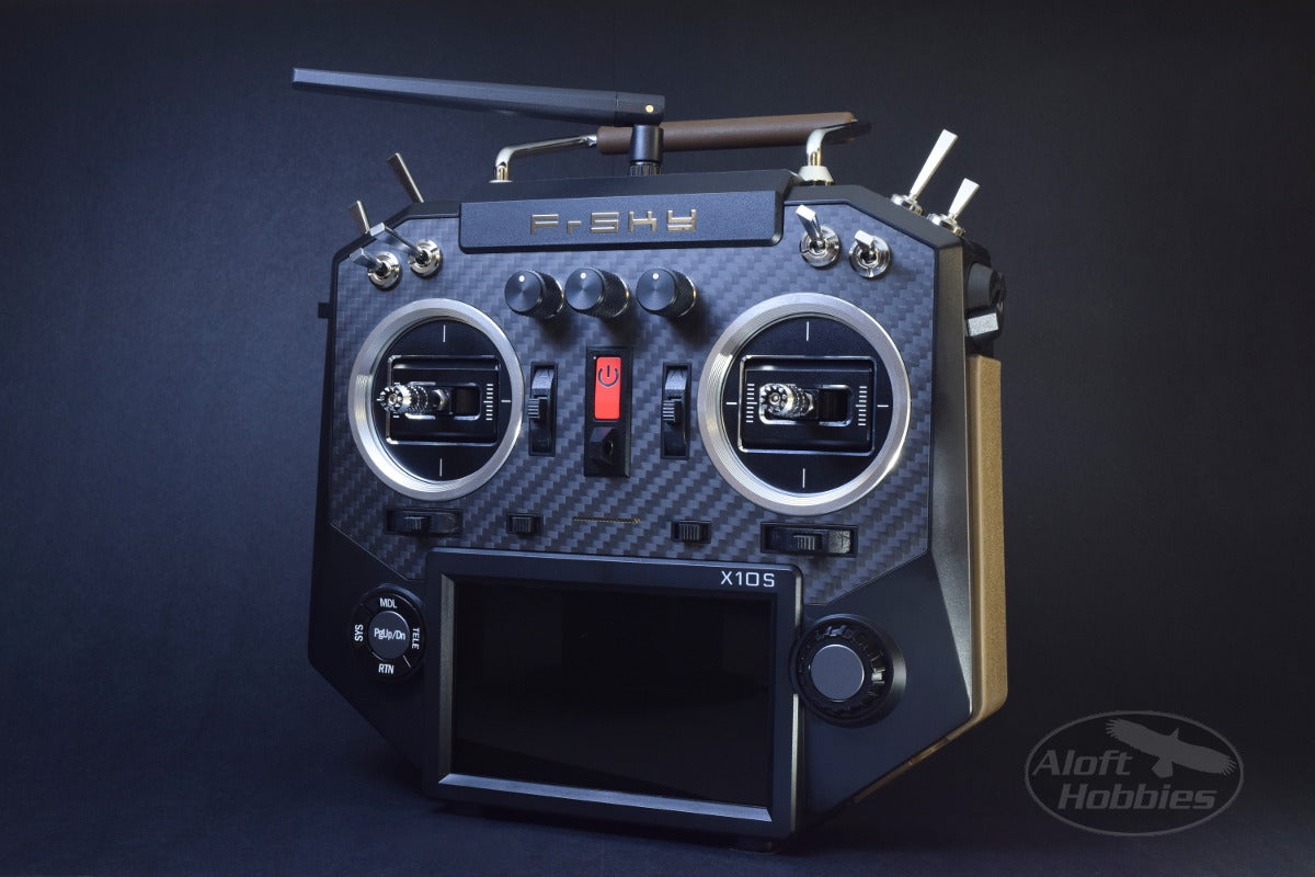

The Horus 10S* is Frsky's flag ship TX (the Horus 12* was a bit of a flop). The only issue is if you want to go with ACCESS or not. I strongly recommend that you do go with ACCESS from the start. While it is not fully implemented it works well and in its current state offers more features than ACCST.
Most modern FrSky RX's can be updated to run ACCESS with a free firmware upgrade. As you are new to FrSky I'd also recommend you start with ACCESS and the Archer RX.

I can only find the x10s Express here, which already comes with ACCESS. I guess that takes care of that decision.
I must admit that I love the layout of the x12, with the screen on top. Why is it considered a flop?

I love OpenTX as I do a lot of heavy mixing with my sailplanes and jets (large EDF). I'm thinking OpenTX might not be worth the learning curve. The Horus is worth the purchase. I have said in the past that if I need another TX it will be a Horus 10.
The Horus X12 was too large. It did not feel good in the hand. With that large screen the balance was off (again did not feel good to hold) and with both screens (it only has one screen) one being color, battery life was a bit too short. I don't know this but I think it only came with the FSOS.

I started leafing through the OpenTX manual I found, and I think I like it! Setting up a FBL helicopter seems very logical. The example there uses an external module to connect to an AR7200 FBL/receiver combo. There is a remark that the Spektrum servo travel range is typically -80 to +80, while OpenTX is -100 to +100. I'm currently wondering whether I would have to take anything like that into account when I convert from Spektrum to FrSky/OpenTX at all. I guess I don't, because all the limits are set in the FBL (microbeastX) anyway.
It's very easy to set the limits to whatever you need in Opentx using the output menu. Then there is extended range as well if you need it. Spektrum limits its normal travel to +and - to 80%. This is done because years ago some servos may over travel their limits causing a crash. In Opentx every perimeter is upto the user to define.
I understand it's easy to set the limits. I'm just wondering whether I would have to limit the servo travel to 80% in OpenTX when the receiver is talking to a FBL unit anyway, because that FBL unit sets the servo travel limits, not the TX. Obviously I want my helis to behave the same with FrSky as they now do with Spektrum. The FBL units would remain untouched, and only the TX and RX would be swapped for FrSky. Of course I have to set expo and dual rates (which I don't use anyway) the same, or, to be more precise, equivalently.
Rule of thumb. Set Expo and dual rates in the input menu. Set mixing if required in the mix menu. Set servo travel limit and Norm/Rev in the output menu.
I played with companion for an hour or two today, and I'm getting the hang of it. I was able to program a FBL helicopter already, but I still need to figure out how to set flight modes, why I already got a throttle cut switch (I believe I know why, but I'm not sure), and whether my way of adding expo is correct. The curve looks like an expo curve, but it does not explicitly say so. Well, at least I am at a point where I could ask meaningful questions if it was for real.
