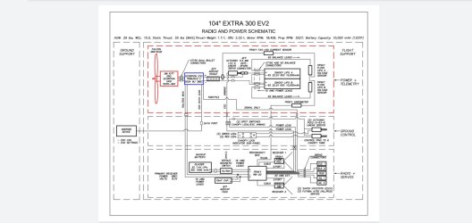

There was a sudden increase in amps from the SBEC to the servos at the time of the uncommanded roll. The spike doesn't correlate with my stick inputs. That indicates a servo movement that my radio had not commanded, or a sudden load on the servos from turbulence or some unknown event. But there was nothing out of the ordinary. No loud bang, crack or pop. Just an instantaneous uncommanded roll.
Here is a brief narrative of the timeline shown on the graph:
16:02:40 Left turn and descent at the far left end of the field, then throttle to max
16:02 :44 Leveled off at about 133 feet AGL
16:02:46 Roll right to knife edge and hold with left rudder
16:02:49 Spike in amps to the servos (anomaly; correlates with uncommanded roll)
16:02:50.7 Left rudder input reduced to correct for slight climb
16:02:51.4 Left aileron input to counter uncommanded roll to the right (plane was inverted in an instant and rolling fast!); left rudder goes to neutral
16:02:52 - 16:02:55 Plane is unresponsive to inputs, possibly due to accelerated stall (snap roll)
16:02:55 Impact

Here's what was on board my Extra. I removed the electronic canopy locks and replaced them with manual levers about two months prior to the crash. I had overhauled the plane (new motor bearings, fixed a bad solder joint, etc.) one week prior to the crash, so everything was working well.
