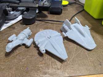

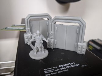

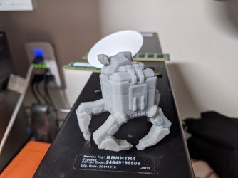

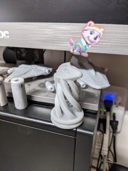

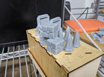

Sorry, I have not been on it a awhile. Congrats on the resin printer, I know I like my AnyCubic Photon Mono SE. Looks like you are getting great results already! All the best.Picked up a Anycubic photon zero for $99. Pretty impressed with the resolution. Dealing with the resin isn't that big a deal I've got a couple pickle jars with some mean green degreaser and a toothbrush and a little DIY from board box I made to cure. 5, 15, 30 epoxy resin has a thousand times worse smell like the resin smelled from this doesn't even bother me and it doesn't permeate my office at all. There's quite a significant difference in slicing these verses filament soak still kind of wrapping my head around this. The interesting thing too is that it does an entire layer at the same time so percentage of fill or how many things you have printing out at the same time doesn't make any difference to how long the prints going to take. The single factor of how long are prints going to take is how tall your model is. So you could be doing one model and let's say that takes two hours. Well if you can fit 10 of those on your bed next to each other it's still going to take 2 hours. And if you build a piece with 2% and fill that's going to take exactly the same amount of time as 100% infill.
View attachment 7528View attachment 7529View attachment 7530View attachment 7531View attachment 7532
