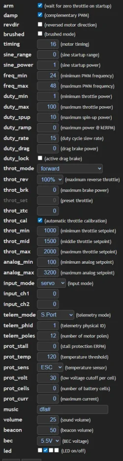

Just wanting to make sure I've gotten everything how it should be to not fry anything.
E Flite Power 60b (470kv 12 pole outrunner) in a 2.0M T-28 Trojan.
Turned off sine, everything else looks good, motor spins up and down fine in the plane.

One thing is the active freewheeling still feels like there is a slight brake. HobbyWing ESCs and other ones just freespin with the throttle all the way down. Is there a way to full unlock it when it's at idle or no? I thought setting damp on and sine to 0 would do this.
I don't think it did anything. Sine was already set to 0 which should have disabled it. No idea but its fine. The motor does freewheel just has a slight brake on it. Settings are all the same as posted above except when complimentary PWM is unchecked the sine stuff and the duty brake are greyed out.
