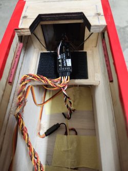

Tell us more about your receiver and how it's mounted in your plane. How have you located the antennas and are they near any objects like batteries servos etc. There is a lot of discussion on antenna location, and this is very important. I mount my antennas one either side of the fuse and I locate them horizontaly in a piece of heat shrink tube or a drinking straw works just as well. Is your receiver inside a carbon fiber model. What receiver type are you using and what firmware version does it have. See my antenna layout image. Are the antennas in good condition are the ends of the antennas in tact..
