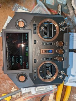

I got the consumption telemetry and call outs every 500 mah working tonight :)

Posting this for others future use more than anything.
