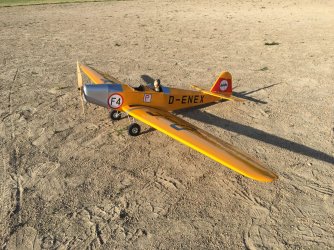

The photo is my kit built Krick Klemm, which I had to import myself, a some cost! I’ll not risk it.
