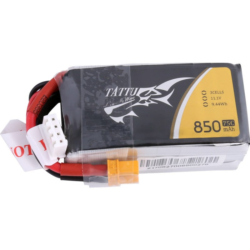

I want to use an external battery for the R9M module in my Horus X10S to extend the time I can fly during the day without recharging my radio. I know I want a 3S lipo with a xt30 connector but I am not sure what mAh would be best.

Thanks so much Wayne for replying. I prefer not to upgrade the battery in my Horus, I would just like to find the right battery that I can maybe Velcro to the back of my TX and plug it into the R9M. Preferably one that doesn't weigh too much or is too bulky. If you could recommend one that you might have in stock that would be great.

Yes, if you have the module with the XT30. I think the largest size 3S with an XT 30 we offer is this one:
I would imagine that would feed the module for a few hours. You could use a smaller pack for less weight, but I think I would go for the larger pack myself.
