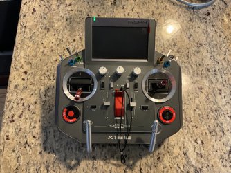

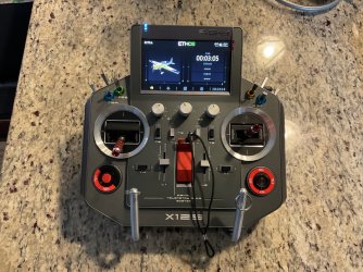

I just did the lipo battery upgrade on my X12S with the upgrade kit from AliExpress
but I’m having some issues…. the installation was very straight forward and went without a hitch however the “power ON LED“ on top of the transmitter stays lit green with the transmitter turned off!?!? with The transmitter on everything is normal and the power on LED is lit blue.
Surprisingly with the transmitter OFF and the led ON there was no significant power draw over a 24 hr period as the battery voltage showed no drop?
has anyone else with this mod experienced the same issue?
