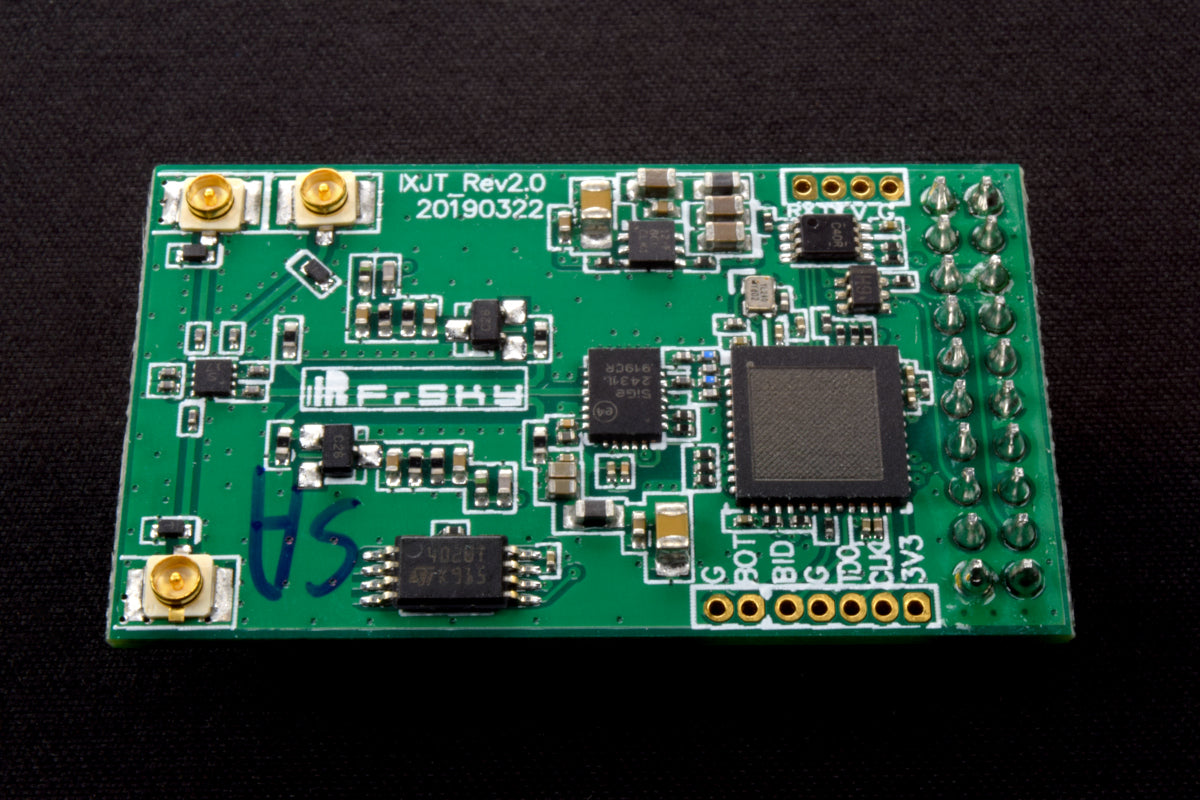

Back in 2017 or 18 I purchased a Horus 10x at the West coast festival fly in in Merced. (Not the S version). I have Open Tx on it, but hoping to find something a little more intuitive for adding, setting up and tuning planes. OpenTX is super powerful and was good coming from a Multiplex radio system but… its not easy to use and when you only add a plane every 3-6 months and beyond, retraining is kind of a pain. The menu system in Ethos looks a little easier to use.
If I were to change to Ethos, what would I need to do to get the Horus up to spec? Sounds like there is a card or board or something that needs to be added prior and then a series of flashes etc. Can you suggest a step by step written for a semi novice?
You will want one of these:
And then there is some firmware and software installs to be accomplished. I found a write up on the process here:
We also perform this update at Aloft if you prefer to have someone else do it.
