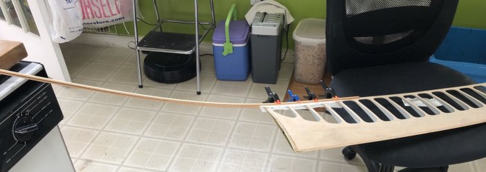

Trying to maintain trailing edge curve. This is odd for me as I’m usually trying to remove curves. On the left wing the foam core was too thick from the OEM at the trailing edge. With a razor saw I split the trailing edge from the top and bottom. This removed most of the abundant foam. I now needed to glue the top skin to the bottom skin. To avoid the common problem with the repair of the Hobie Hawk were we get kinks in the trailing edge. I’m preloading the trailing edge with its “fixturing” by suspending the wing between two points. I allow the fixture to bow under the weight in hopes that I maintain the trailing edge curve while the glue cures.

It worked! While I can’t get any photos to show that there're no discontinuities between the repaired trailing edge and the un-damaged trailing edge. I can show that the root area of the wing is now in much better shape than it was when it came from the OEM! Note that I’m using expanding urethane glues to fill in any voids. This has worked rather well.
