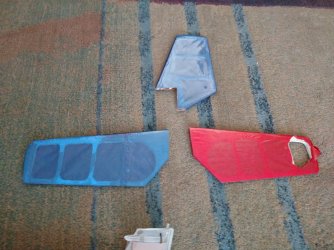

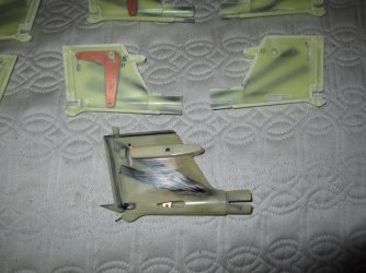

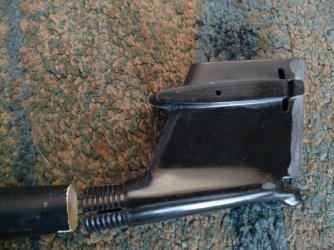

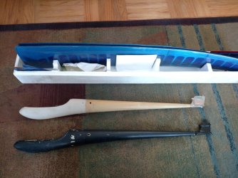

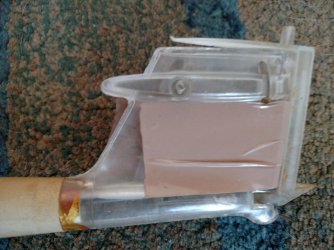

Here are some of the dorsal references attached. BTW, I have a brand new unpainted fuse and the dorsal is not ABS, it's poly-carbonate. The image with the dorsal split into different components are the prototypes made by Tony. If you need, I also have the dorsal .stl files that I got from the rcgroups....

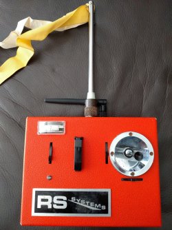

The R/S radio from the early 1970's is for the Hawks I'm fixing, but with slight change in frequency ?

I think they were originally ABS, then poly-carbonate?? Or the other way around.. The spares I bought were the last plastic injected versions I am aware of, said to last longer and were clear. I think I paid $50 or more for each many years ago.
Love the radio too! Will be a sweet setup when done. What does your Hawk look like?

Thanks for the correction on the material for the stab mount (dorsal fin). Mine still looks a lot like ABS.
That is a very good point about the loads on the tail as tail slams down when the nose hits the ground. I was planning to make a thin walled carbon tube to replace the cone wedge in the drawing. Then I was going to add six or so layers of 0.7 oz glass across the joint on the outside. (As it is now the paint is so thick that I can flare these layer without causing a bump). I really think this joint needs a lot of fiber across it.

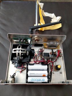

I may need to bring out my analog mixing Silver Seven. I don't think I have converted her to 2.4 ghz.

Here is my #2 Hawk for some reference. The black dorsal is the new replacement from Tony. Looks really good just needs a little finishing before paint. It's much stronger especially when comparing it to my polycarb one on the new fuse.
