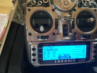

well got a life rx pack i had on hand and the balance connector plugs right in and hope to find A123 2 cell pack somewhere that will give plenty of capacity. meanwhile i turned on the tx and though i can scroll to some setup for a plane i cannot get very far and have been unable to change a single thing. i obviously need an instruction tutorial

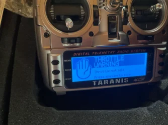

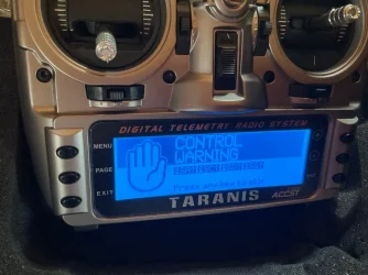

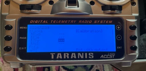

The Taranis is going to be a little different than the radio you are used to.. It is very different. Push and HOLD on the MENU to get into the system settings. A short push of the menu button gets you into the model setup, and from there use the page button to cycle through the screens. Maybe start with checking the radio settings and not a bad idea to run a stick calibration.
slow going. the rudder trim sometimes changes values. other screens i cannot change anything
