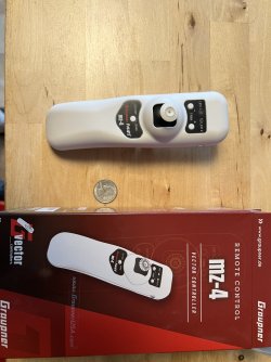

I've purchased a Punkair Agilis paraglider along with the recommended single-stick, one-handed transmitter, a Graupner MZ-4. It's a 2-channel 2.4GHz radio.

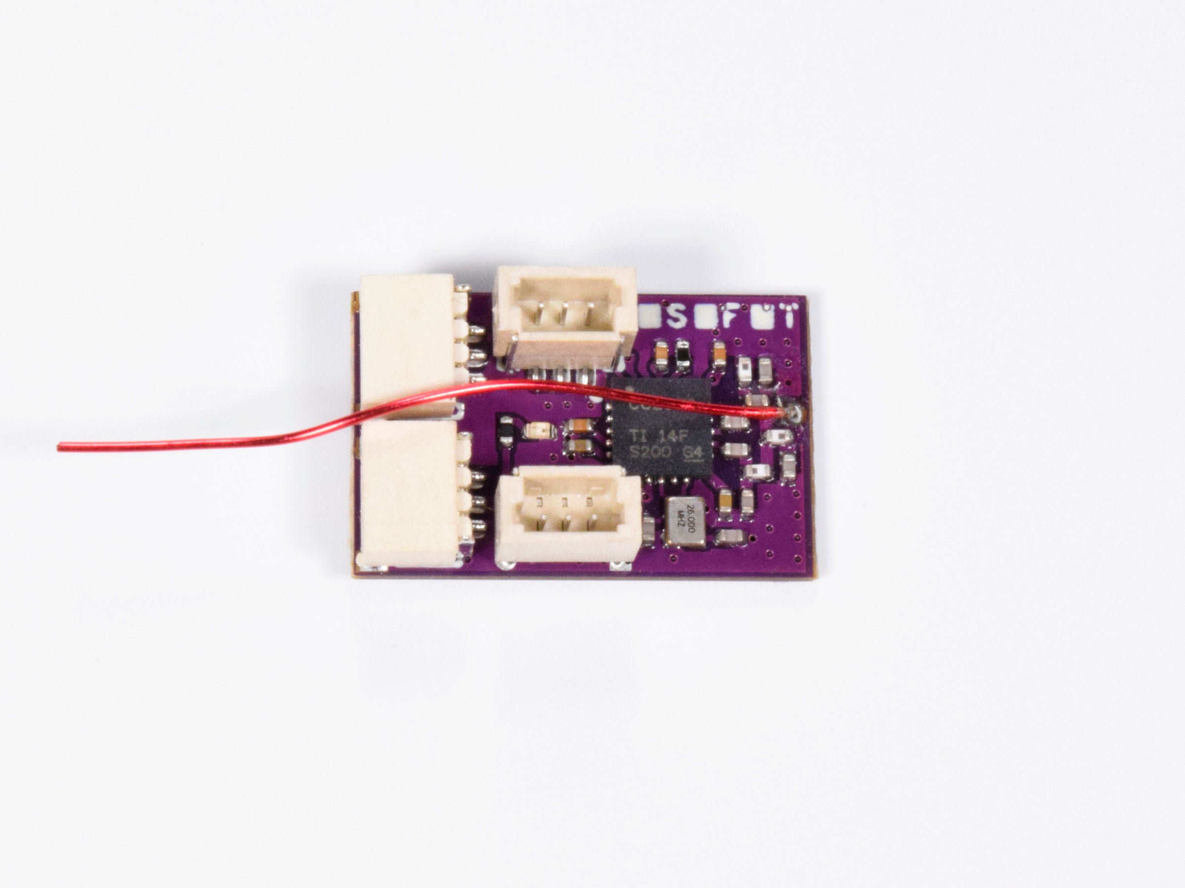

Ok - Had not seen this plane before. It is a lot smaller. Looks like they use motor for up and down, and then just change the thrust left and right to make turns. A micro setup should be able to get you going. What radio system do you currently have? You will want to find a micro receiver with a brushed ESC and then add one mirco servo.
The receiver will be something like this:

The transmitter I have is a Graupner MZ-4. It is a 2 channel 2.4 GHz radio FCC ID: SNL-16007400. I think I found a compatible (HoTT) micro receiver that has an ESC built in.
I'm going to pick one of these up and make sure I can bind it and that I understand what size connectors it uses. Then I'll come back and ask more questions about servo/motor/and prop once I know what the physical realities are in-hand.
