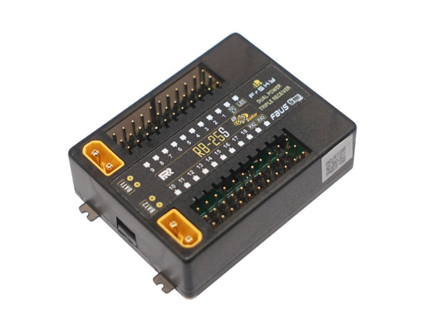

The use of the RB systems could be a benefit for this model. It is not required, but as you push into bigger and bigger models the Redundancy Bus adds a number of very helpful safety features to the model. Think of it as an insurance policy, it can guard against a full system shutdown should a servo fail in a very bad way, etc.

RB25S:

That would be a pretty good system that will give you the vario, stabilization, dual receivers on dual bands, and the RB for power distribution and security.

But Does the RB25S have the built in Vario?

Yep - Sorry about that, the RB-25 and the RB25S do have a varios. LOL - I didn't know that until now. :)
