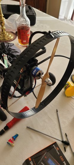

We had some fun with the shop paramotor pictured above, and learned a fair amount. Some notes:
They are pretty mellow and both very easy and also kind of hard to fly. I think just about anyone can fly one arround when setup correctly, but setting them up and getting the most out of them is a bit of a learning curve.
The setup is critical for best performance.
In winds, add more weight, not talking ounces here, think pounds. I think we had a couple of pounds of ballast on ours to get her a bit more sporty. Basically, the more weight, the better they turn, and the more wind they can deal with.
The open style sails as shown in both craft above are very prone to collapse. (Pressurized sails should be much better, but cost a ton more.) They can be re-inflated with enough time. When they collapse, usually it is just a partial and it is annoying.
We ended up with some silly mixing to make things work a bit better. With ours we pretty much avoid using both brakes at the same time as that simply results in a collapse.
Have to be smooth on the throttle ups, sudden throttle increases with get you the thing rocking like a 3 year old on crack.
They don't care for turbulence much at all.

Ugh... I should probably start a new thread for this but it's the same model so I'm not sure. Please let me know if this is annoying.
I went to fly the paramotor on a quieter day. Promptly crashed and got the lines tangled in the motor. The radio throttle got stuck on because I accidentally flipped the switch and I burned out the motor and possibly the speed controller (smoke etc.) The hobby shop guy said it seemed like speed control was toast by the way it was behaving. The radio registered a fault so I shut everything down and went home. Two lines were cut on the canopy by the propeller.
Anyway, I went to the hobby shop to see if they could help. I got a new motor, speed control and a wooden prop. I got it all assembled and it seems to operate fine but now when I start the radio (after the accident not just since the new components) I get a stuck key warning and then the throttle trim goes all the way up. I can adjust it down to neutral again but if I go too far it will not adjust up.
All the controls seem to work fine after that but it's a bit distressing and I'd like to get it fixed if I can. Any thoughts? It was only the third time I've tried to use it and I'm rather disheartened.

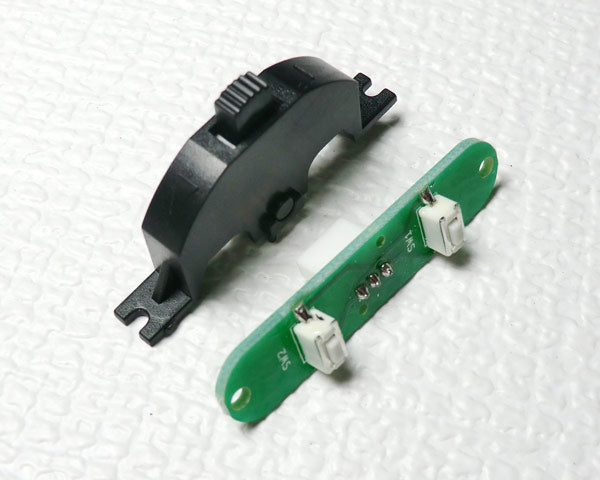

Hmm, looks like you have a bad trim switch on the throttle. Pretty rare to happen on the X10 radios. Pretty sure the throttle trim is one of these:
but the lower trims are on the main mother board (luckily those are fine on yours). I might be remembering wrong, but pretty sure this is correct.
If you are comfortable opening your radio, you can probably pull out this little board without much trouble and make sure it is plugged in correctly and if you have any contact cleaner or some isopropyl alcohol you can clean the switch and probably get it to behave for a while. But a good idea to just get a replacement.
There is a little arrow on that board, note what way it points so you can put it back in the correct orientation.

I took it apart and everything is clean and as it seems it should be. I'll order the replacement switch, it came out very easily.

Alas, I've just tried both switches in the radio and the trim switch problem persists ?
