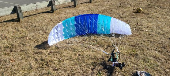

Ok, I might have crashed it but it's fixed again and now I know how much wind is too much wind. ??

Our experience was pretty similar.
What we thought it would be like:
What actually happened:
Our wing seemed to have taken a liking to Wayne in particular. It certainly didn't behave itself on the ground.
I wish, but no. It was a kit we demo'd a long time ago as we were thinking of bringing them in. It's not an inflatable wing (not sure what the terminology is here), so it collapses if you do anything approaching erratic. Flew like a sponge, we've brought it out a couple of times just to mess around. Then it usually ends up back in storage when we remember how poorly it flew. It is good fun though.
I guess sponges don't really have the most radical reputation ?. I'm hoping to get into a full size one and thought this might be a fun way to learn a bit about flight charecteristics without breaking my neck or the bank. I'll try and get Stephen to take some photos next time out. ?
