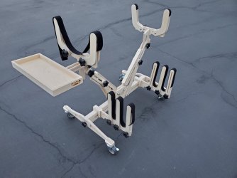

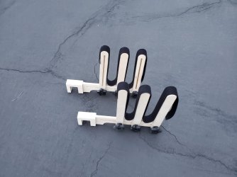

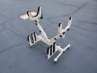

I know one thing. Glen, at rcplanestands, is a workaholic. I'm not complaining though. The man works his butt off to not only produce a bunch oftop quality work stands, but is always open to ideas.
I spoke with him about two weeks ago about drilling the base of one for dowels to be inserted to hold a set of wings, safely, to avoid hanger rash, just to make sure there was enough "meat" to do it.
He not only said there was, but asked me to give him two weeks because he had a plan to take that idea and make it better.
He not only did that, but knocked it out of the park.
I give you the wing rack for the rcplanestands.com floor stands, available in standard, max, and mega depending on the weight of your plane. The standard also can be ordered with small fuselage holders for planes smaller than 1/5 scale.
The wing rack upgrade will set you back an additional 85 dollars.
Mine, prior to shipping. Tested and approved. Made in California, USA
It's almost too pretty to use lol
