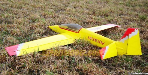

Reminds me of Kolbutin ( pure 3D glider) or the Flip (motorized version) both by Top Model in Europe. The horizontal rotates 90 degrees up/down to spin the around..

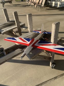

Gremlin E
After I cut nose off a little heat to get fiberglass motor plate in for 28mm motor.I use a tapered down dowel to help get it formed. It is glassed inside and out. The motor is a Medusa 3600kv with maxon 4.4-1 gearbox. I will get video on Saturday.
