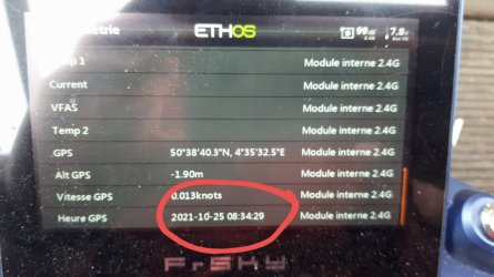

HELLO, X20 latest firmware.

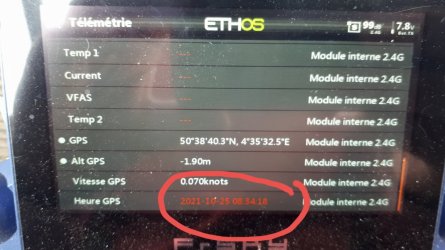

-1: loss of signal by regulated interval (20seconds) on the gps HOURS line.

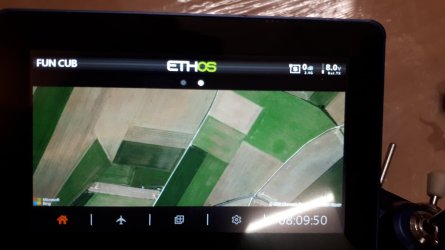

-2: how to encode the corespondent GPS coordinates of the map which is programmed for the widget ??? The rotary knob does not work, the + and - neither

Hi have you tried entering the coordinates with the dial wheel before choosing the picture. And also adjust the travel for the dial in the bottom. That worked for me on the 1.0.11 version
This takes a long time to set each coordinates.:confused:. There is no other way?
I ran into a similar problem testing a GPS sensor on both a X8R receiver and a GR6 receiver, I had to change the update interval of that sensor datum and it stopped giving me the problem. On mine, using both a X12S and a X10S with the ISRM modules upgraded and Ethos 1.0.11, it defaulted to 10s and I changed the update interval to 1s (which is too fast, but haven't experimented with it yet to see what works best). Haven't tested with 1.0.12 yet, though...
