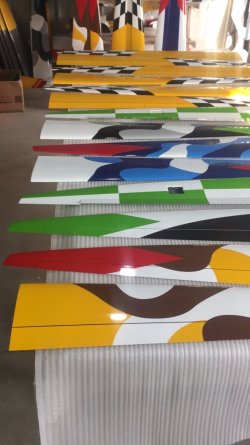

Its beginning to look a lot like Christmas...hahaha - samples are here!
Oh - the two Firebirds?
Very Christmassy in Namibia - they are "Desert Camo", and "From Russia with love" Colour schemes.
The Schwing Forza's are "Lean Green Racing Machine" and "Yellow Peril" - just for reference!

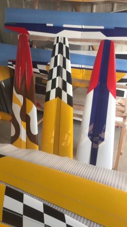

Doc. in image 5574 I notice that the wings have tips of vastly different sizes. The butterscotch/red camo one has a very large tip. And the green camo one looks to be much smaller than the butterscotch/red camo. What is the reasoning for the different size wing tips.

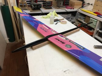

I ask as I've cutdown the aileron on my "Mibo Dart III" to try to control the early stall we often see when the aileron hinge line goes all the way to the tip. As this is a simple mod (No changes to the mold needed) I'd like to understand why the various wing tip lengths.
In IMG 5570 I'm noticing a lot of dihedral in the one piece wings (60"?). I saw this earlier and thought is might be an artifact of the lens. But it looks to a design feature. Normally I don't like a lot of dihedral in my full house sport ships. And if this is the wing to the Firebird I'm really curious, as I really don't like my rudders to be coupled to the roll axis in my racers.
Enquiring minds want to know,
First few were cut wrong, Konrad - no big deal but I'll check to see that after the wrong ones (only one set cut too close) they are OK.
Yep that what we did with Chris' (Aloft) "Density" - I'm surprised that more F3f models don't do this.
BTW I think your cut out is probably OK on the Dart and although it should fly safer, I bet it makes little if any different t the all rate.
Trying more dihedral and it seems to be working well for the racers and fast models but still looking at it.
