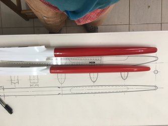

Some bits.

Love the smaller cross section fuse with FAI radiused nose. Looks like the nose moment is shorter? Looks like it might be done to aid in post stall spin recovery.
Sorry to see that the Redshift Mk1 and Redshift Spada won't have interchangable wings. (I think I understand why).
Wow, the airfoil looks different (thinner and the nose is different). I also see that you are stepping down one size on the alignment pins.
With the smaller fuse, I assume it will only take wing ballast. Will the joiner be fitted to accept ballast slugs (to minimize GC shift)?
I'm liking this!

Hi Konrad:
Nose moment is a bit shorter, as we don't need to much length to balance given the lighter tail end. Hopefully it will help with departure recovery.
Actually the wings will be interchangeable. The fuselage you see there is not the final version. That also why the aerofoil looks different.
Alignment pins also remain the same as the old one.
Yep only wing ballast, but yes as you say the joiner has slug holes in it - It can take a surprising amount of lead.

I do like the wide V wing root.
I assume the "new" airfoil didn't work as well. Will the Spanda have the same airfoil as the Mk1? I recall you saying that you were changing the airfoil a bit. (Was that what we see in the prototype fuse)?

Hi Konrad, actually I think Ihave confused you.
The skinny fuselage that you see actually is not a Spada type. Its a fuselage that belongs to a project that I was involved in the design of, but didn't come off in the end. It was made AFTER the first Redshift, so maybe you could call it a "practise" Spada model.
YES the SPADA SPA-DA (Not SPANDA by the way) will use the same aerofoil as the MKI - just smoothed a bit. The old wings/tails will fit the new fuse with no discernible difference.
Tails are larger by about 15% and the V angle is reduced from 104 to 100 degrees.
Hopefully these improvements will make a difference.
J.

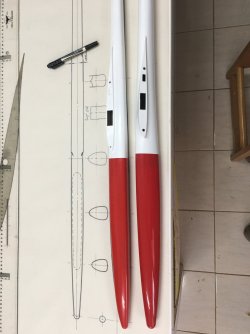

So what "bits" am I looking at? From context I thought I was seeing the original Redshift Mk1 and new Spada fuselage and drawing.
If the tails fit between the Redshift Mk1 and Spada, I'll want to order 2 sets of Spada tails for my Redshift Mk1s. As you know the tail volume is the only real design issue I have with the Mk1 (some directional instability coming out of a turn).
-Konrad
Hi Konrad - In this view the fuselage below is identical to the Spada.
Redshift 1 is the fuselage above.
The line drawing the fuselages are sitting on, is of the Spada.
Doc
I like the cross section in the drawing (large bottom to allow servo arm and push rod clearance with inverted servo mounting).
But if the wings are interchangeable I see a problem with the wing root. Project X and the drawing have the wing roots parallel. The Redshift Mk1 has that nice V wing root.
I'm at a loss as to how these wing roots configurations would allow wing interchangeability.
Konrad - Sorry I have confused things again.
See below.
I LIED - but not on purpose. The "Project X" drawing below the models is actually the scrapped project NOT the Spada.
The New SPADA DOES have the wing joining angle so I didn't lie about that.
Actually I forgot...probably that damn Al guy again...Dayum!
