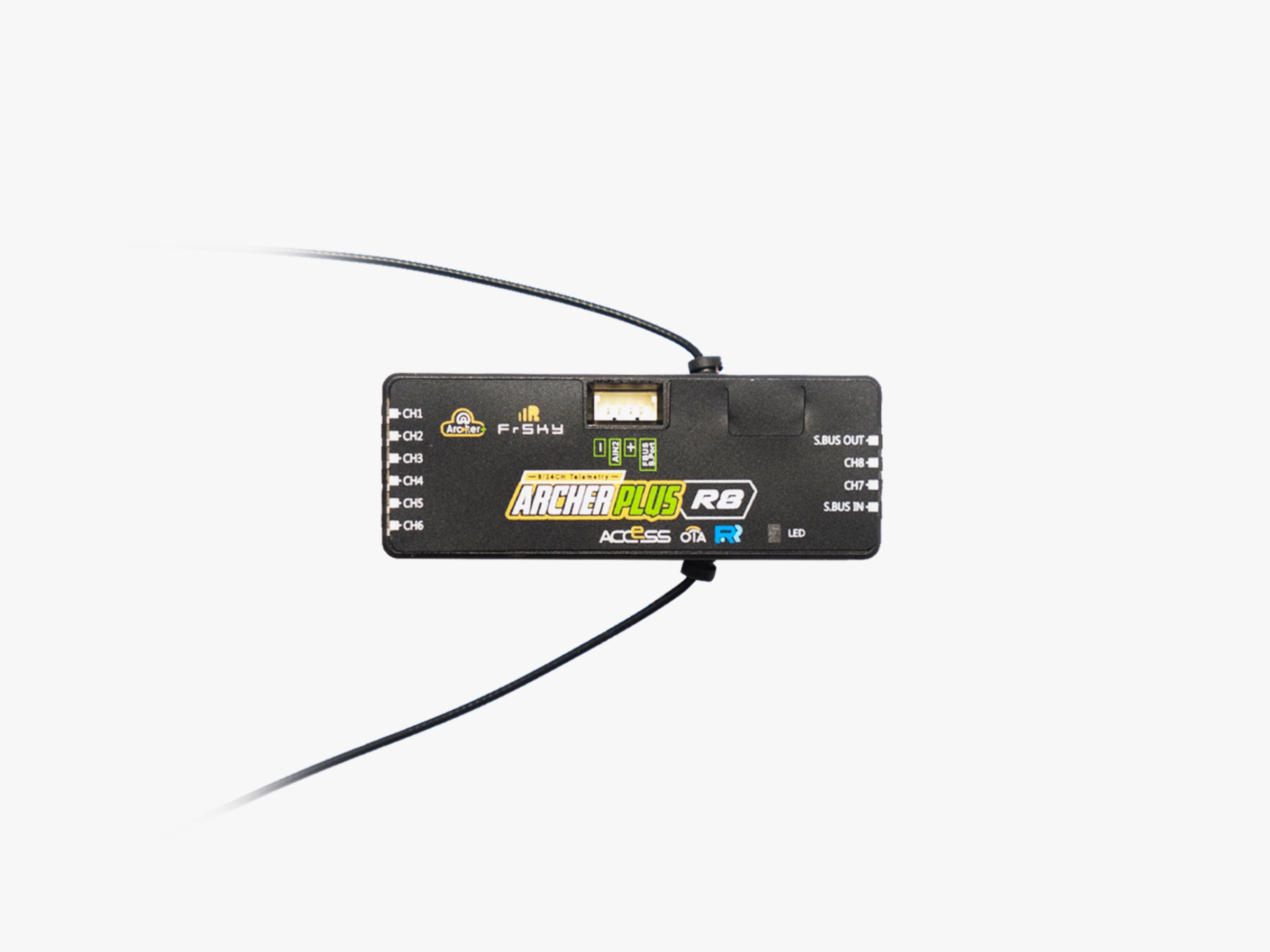

Another option would be to use something like our X8R with Uni firmware installed. It is a great replacement for the D8R-II, just need to bind in D-16 mode on the Taranis. And you should be good to go. We are currently sold out, and waiting to hear from FrSky if they have any more of these available, we may have run them dry. It is a very old receiver at this point.
The other option would be one of the Archer receivers, this will require you to upgrade your RF firmware to a current version. (This is not OpenTX firmware, but the RF firmware. I think you should also update OpenTX at the same time.) The Archer R8 should be a good fit for you if you need 8 channels:
