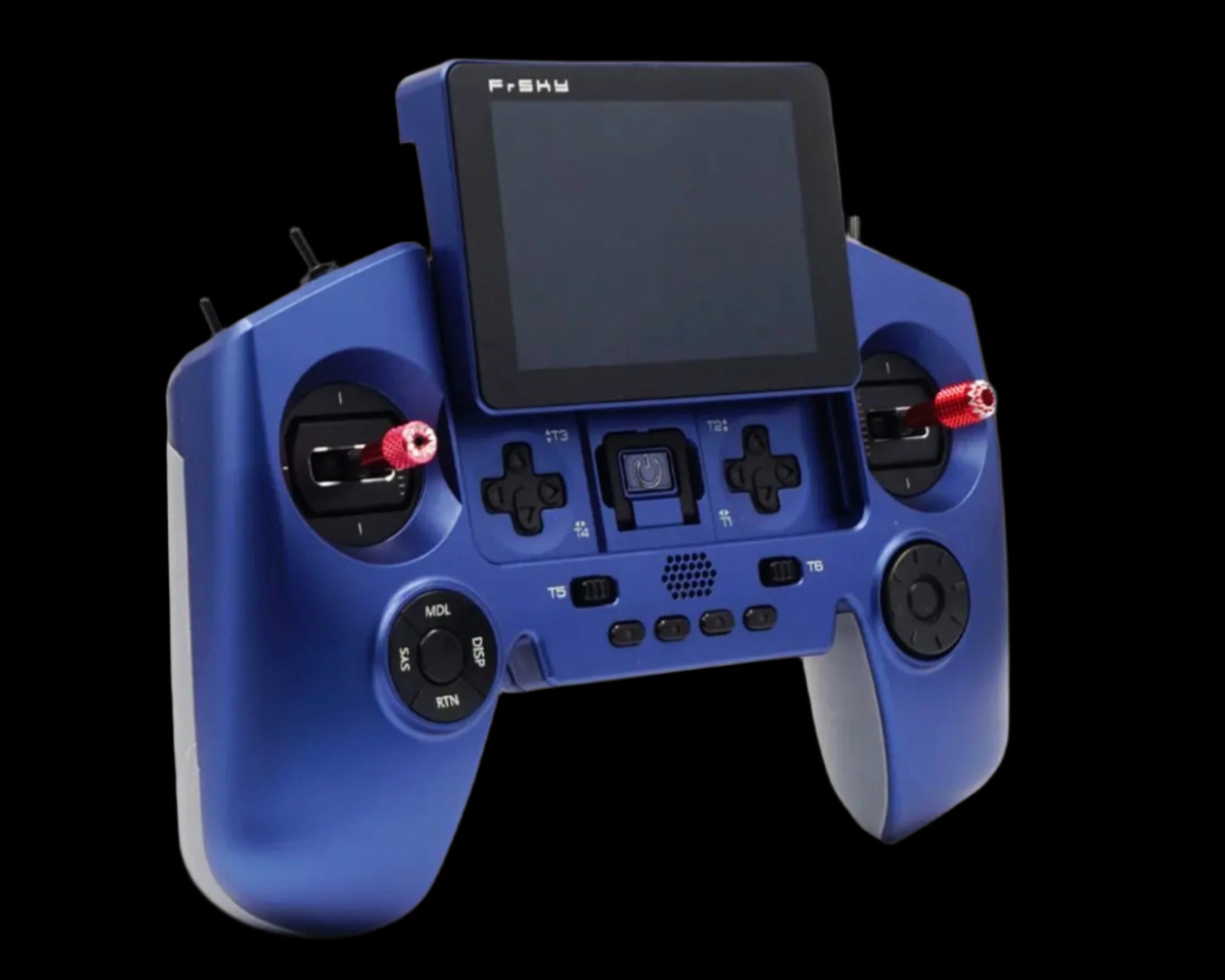

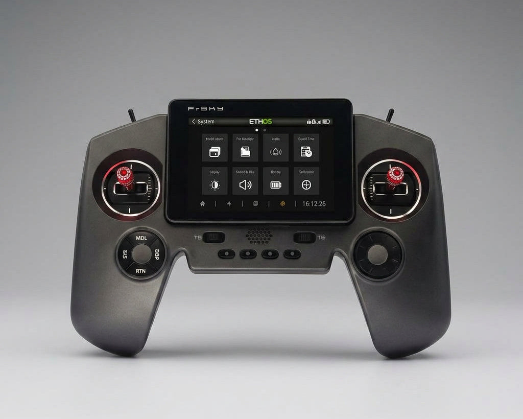

@John in Boston this is one of the main reasons (aside from age of old radio) that i switched to x20. The touchscreen. Cause thats what happens, your radio sits for months and you totally forget what the HECK is the back button lol. If you ever do decide to upgrade they have a version of your radio now with a touchscreen, its pretty cool.
Just having a keyboard appear on screen that you can touch is a great quality of life option for setting up new models.
