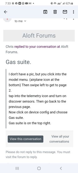

T Txmustangflyer Strong User Feb 4, 2022 #3 I sent Chris a message. Hes researching it. I assume you are hooking the gas sensor main box into the sbus and all sensors into it, yes?
T Txmustangflyer Strong User Feb 4, 2022 #4 How about this one? Attachments Screenshot_20220204-193324_Gmail.jpg 112.1 KB · Views: 302
