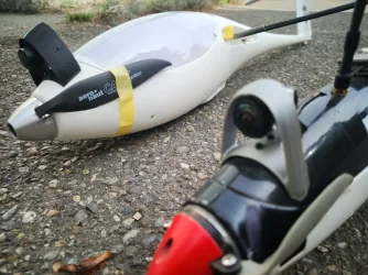

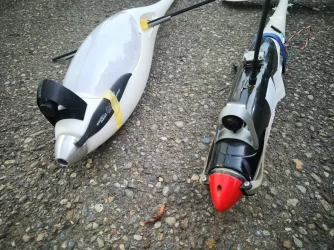

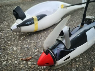

I've seen some folks use head trackers for FPV sloping, so the camera turns as your head does. Neat idea in theory but it wasn't for me. I prefer wide angle lenses for lateral vision. On my Volantex Phoenix I have a 180° Horizontal FOV with a lens like this:
Short clip of how that looks:
I also prefer flying pure manual... always feels like I'm fighting against a flight controller or stabilizer.
