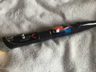

Hi JJ, I’m with Wayne here. Look upon the bottom feeding ballast tube as a structural component, as it crosses from what you could call the ‘main’ fuz line into the inner nose/radio area. The tube/fuz join can be strengthened with glass/carbon or Kevlar if you want, but it really isn’t necessary IMHO. The servo tray is then bonded to the top of the ballast tube, and the whole thing ends up good.
The tube does need a tapered infill bonding to it to take into account the change in shape of the fuz bottom, no doubt you’ve already realised this. I didn’t use epoxy to bond my tube in, I used a good amount of a fancy industrial adhesive from a hardware store, then more of it to create decent fillets to the fuz bottom.
Nearly 3 years old now without a problem (but I do have grassy landing areas!), the only thing you might want to do other than just fitting it out, would be to sand back the flap roots a little to give more clearance between them and the wing root area on the fuz. CG at 102 is perfect!
