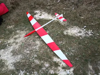

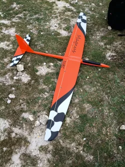

Hi all,
I’ve just had my first flight of the year with my Forza and am grinning from ear to ear (not pretty).
I took the Magnus out to “test the water” and she was really ripping, so the Forza was rigged up and given a chuck.
She’s just so great to fly and can just take anything that’s thrown at her. I’d say that the more extreme the conditions, the better she goes.
I’ve got something arriving in the post tomorrow that should double the fun….:)
Martin
