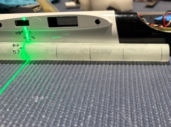

Hi Forza fans :) I have a question about CG trimming for you, cos I’m scratching my head a bit.
I’ve been flying my Forza a fair bit and have gradually moved the CG back to around 100mm. I think it needs to go back a little bit more, as she still pulls up a bit when travelling fast.
My slight concern is that with the model trimmed for fast-ish straight and level flight, I’ve got about 1mm down trimmed in (see photo)
Is this normal?
Cheers, Martin
Mine sits flush. I do not recall where my CG is, but as I recall the published number is pretty darn nose heavy. One of my local pilots has been dialing his in and said he has kept moving the CG back further and further.. Getting closer each time.
Thanks Wayne, yeah I think that’s the stage I’m at now. I’ve removed all the loose lead that I had in the nose and am adding slips of lead to the tail end now.

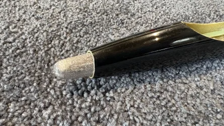

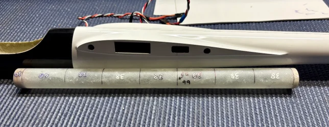

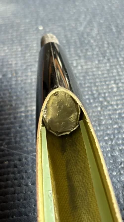

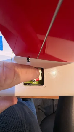

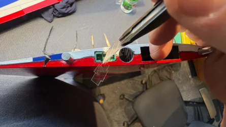

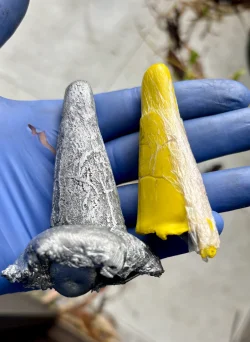

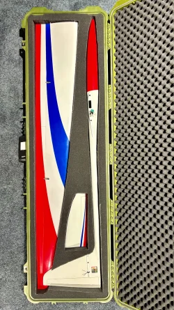

Well, As my build drawers to a close I thought I’d just upload some photos which I think are cool - they represent building techniques I’ve never used before like casting lead nose waits, gluing multiplex connectors into wings and fitting dual servos into impossibly tight spaces like the tail…. Was all very time consuming but kept me entranced all the way through…. Lots of great advice here from all you guys…
